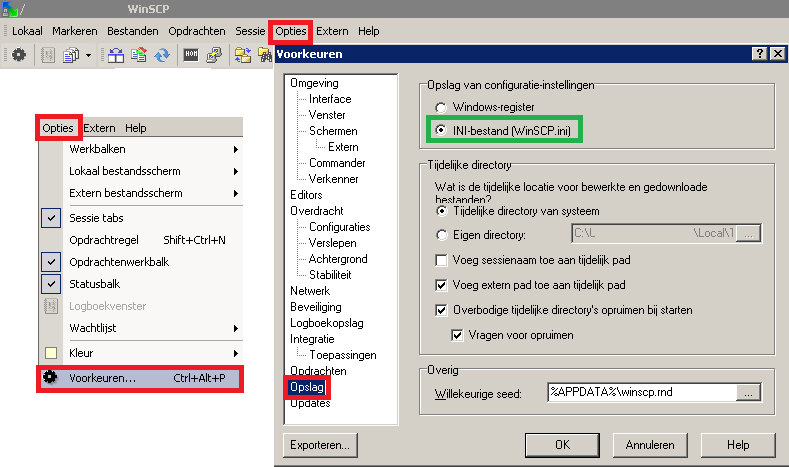

eeman82
Solution to problems with SQL Server Agent connecting winSCP
I've read several stories about failure connection to WinSCP. The problem lies not within SQL Server or SSIS, it's the configuration of WinSCP. You have to change the configuratiefile settings for WinSCP so SQL Server can connect to WinSCP (see attachmentin Dutch).
Without this option your SFTP connection will work when you try it in SSIS and will fail when you schedule the task with SQL Server Agent.
Hope this works for you,
Gr. Erik
Description: WinSCP configuration
42,825
Re: Solution to problems with SQL Server Agent connecting winSCP
Thanks for sharing this.
This is described in the article in my very first post of this topic.
