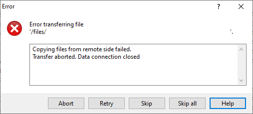

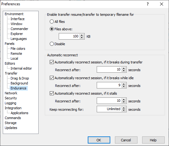

Whenever a transfer is failed and contains: "Copying files from remote side failed.", WinSCP do not do auto retry. Settings under "Endurance" in Preferences has all been set. There are screenshot attached for reference.
Is there any way I could make WinSCP do an auto retry? Or could this be a "feature request"?

I'll get back to you soon when I encounter the error again (I'll try until I get it). The server is a server which i have no access to (an FTP server from my University faculty).
A related thread was already created in the past, though as per to unspoken forum rules, I refrained from necro posting especially with the fact it was many years ago. Such is the link: https://winscp.net/forum/viewtopic.php?t=7488
What is particularly similar with me and the OP is that this happens randomly. Though however, to the best of my attempts, this may be a problem with the server and not with my personal setup as this can also happen on other different machines and clients too! Fortunately, "Retry" works and the files will resume download with their integrity intact.
Which is why I wish for auto-retry to work for this particular error. It would be nice to be able to download huge files without having to attend the program.
An alternative FTP client would able to auto retry on error. But hey I love this client more!
Sorry for the wall of text, as mentioned earlier, I will come back with a session log

Continuing this same topic, I am encountering the same issue. My package has been running fine for months, but now the last 3 days the process is bombing on the step to upload files. I have about 700-900 PDF files to upload once per day. When I do this manually through the interface there are about 20 files that result in the "Copying files to remote side failed" error. I can simply click "Retry" and it immediately works as expected and continues on until it reaches another problem file. I don't see any reason that these files would fail. I confirmed I can reach them and open them and they aren't corrupt or huge in size or anything.

They seem to be one in the same, but sure, let's please start with focusing on the GUI. When logged into the GUI and selecting 1000 files to copy over, I have to manually press "Retry" when one of the files encounters a temporary error. I press Retry and the process continues on as usual. Is there is way to configure an automatic Retry without user intervention?

Martin, thank you so much! This new build worked both within the GUI and for my script package. With this build, it now honors the "disconnect" settings on the Endurance tab and gracefully (automatically) retries the connection. The previous version required user input.
