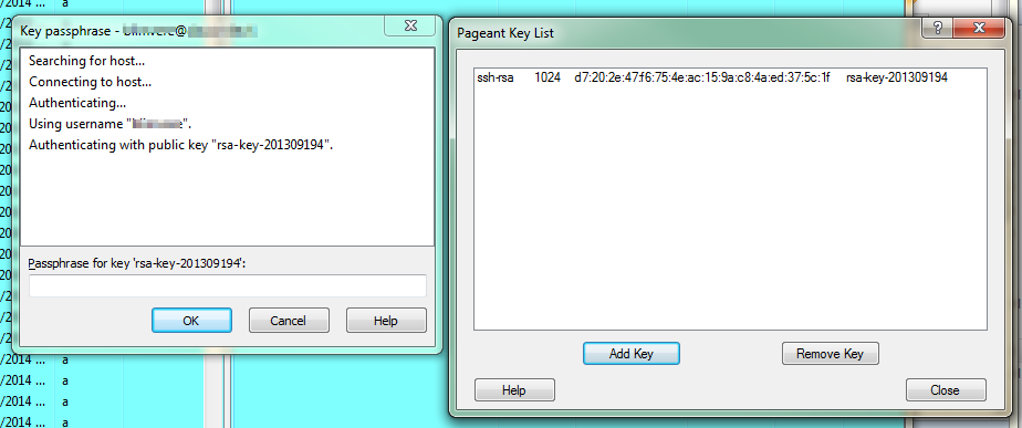

I recently upgraded to WinSCP 5.5.1. The upgrade process kept all of my defined sites. I use PuTTY private keys and pageant for access to most of my servers. Since the upgrade WinSCP is asking for my keep passphrase each time I log in, even though the key is loaded in pageant. This is new behaviour since the upgrade. Below is a screenshot of the winscp dialog next to the pageant window showing the key.
This is inconvenient as I have to log into numerous servers to collect logs.[/img]

This probably means WinSCP does not see the Pageant at all. What version of Pageant are you using? Please attach a full log file showing the problem.
