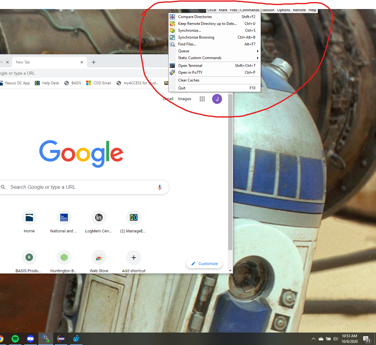

Main Menu Bar Locked To Monitor
My Menu Bar (Local Mark Files Commands Session Options Remote Help) Is stuck in the Upper Right Corner of my Main Monitor.
I can move The Window to any of my screens, But the Bar stays Fixed in position on my Main.
I cannot move the bar.
I can Only drag the right side to change the shape and orientation of Words.
Left Upper Corner stays Fixed.
Almost looks as if the top part of the bar is off screen.
When Winscp has the focus the Bar appears, If I click on something else and WinSCP looses the Focus it Dissappears...
I don't know how it got outside the window.
How do I get it back into My Winscp?

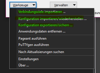

The trick with the registry didn't work for me. But this:
  1. Be sure not to wear some flowers in your hair, but to have a backup of your configurations. ;-)
  2. Uninstall WinSCP
  3. Install WinSCP. Now the Menu is visible again.
  4. Load your configurations (see screenshot).
HTH
Description: Don't forget to save your configurations.
