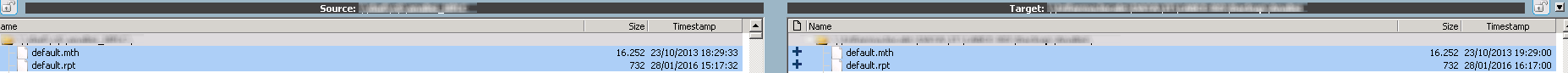

Re: FTP sync and timestamp
no upload, the need is only to download (mirror) an ftp to a local ntfs folder using winscp sync.
i made a small test enviroment and generated a complete log and new screenshot.
please see attachment.
You can see that every file "last modified" attribute on target has:
- seconds set to 00
- hours set to +1
  • test-compare.jpg (200.27 KB, Private file)
Description: source and target timestamp compare
  • test-backup-01.log (52.08 KB, Private file)
Description: winscp log
Sorry, but I do not understand. What does the screenshot show? What software is that? How is WinSCP involved?
OK, what is "source"? The local machine (as the other is "server")? Or the remote machine (as it's the source of the download)? How do the timestamps look like in WinSCP (both panels)? Can you post a screenshot of that?

the source is the ftp server (remote, source of download)
the target is the local smb server (local, destination of download)
in attachment site settings and window compare.

tester.it
6
Italy
correct. settings offset to -1 seem working (dunno why in previous test didnt worked).
thanks.
how to apply offset to my powershell script ?
  • winscp-timezone-offset1.jpg (61.09 KB, Private file)
Description: timezone setting modified
