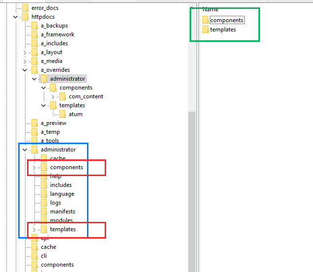

Hello Martin,
thank you for you fast reply. I drag from "right remote dir" to "left remote tree" (both on same server).
I copy marked green folders with Strg/Cmd into blue one / after dropping then the red folders are emptied and contain only my override files from green – what is not the usual behaviour.
Check the attached image please.

I mark in the green folders and drag them in tree into that blue one.
Red folders have of course lot of folders inside. But once I drop greens into blue then red are complete empty and then there are only that folders left that are contained in green.
They get emptied. I can shere AynDesk with you and show you...

Anyway, by default, when you do what you describe, the contents of the target folder indeed get overwritten. You should get very clear warning about that before, like this:
Directory '/.../administrator/components' already exists. Overwrite?
All files in the target directory will be deleted!
If you opt to duplicate via local temporary copy, the behaviour is somewhat different. One of the differences is that the files in the target folder won't be deleted.
