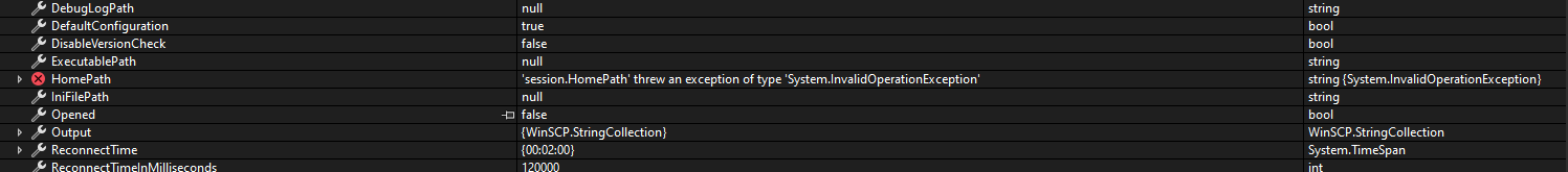

File are in attachment.
I noticed /ini=nul
[2022-02-22 13:28:50.139] [000f]       Starting "C:\tbass\rest\winscp.exe" /xmllog="C:\Windows\TEMP\wscp0EB0.004AEE1D.tmp" /xmlgroups /xmllogrequired /nointeractiveinput /stdout /stdin /dotnet=5.19.3  /ini=nul  /console /consoleinstance=_3760_50754959_512

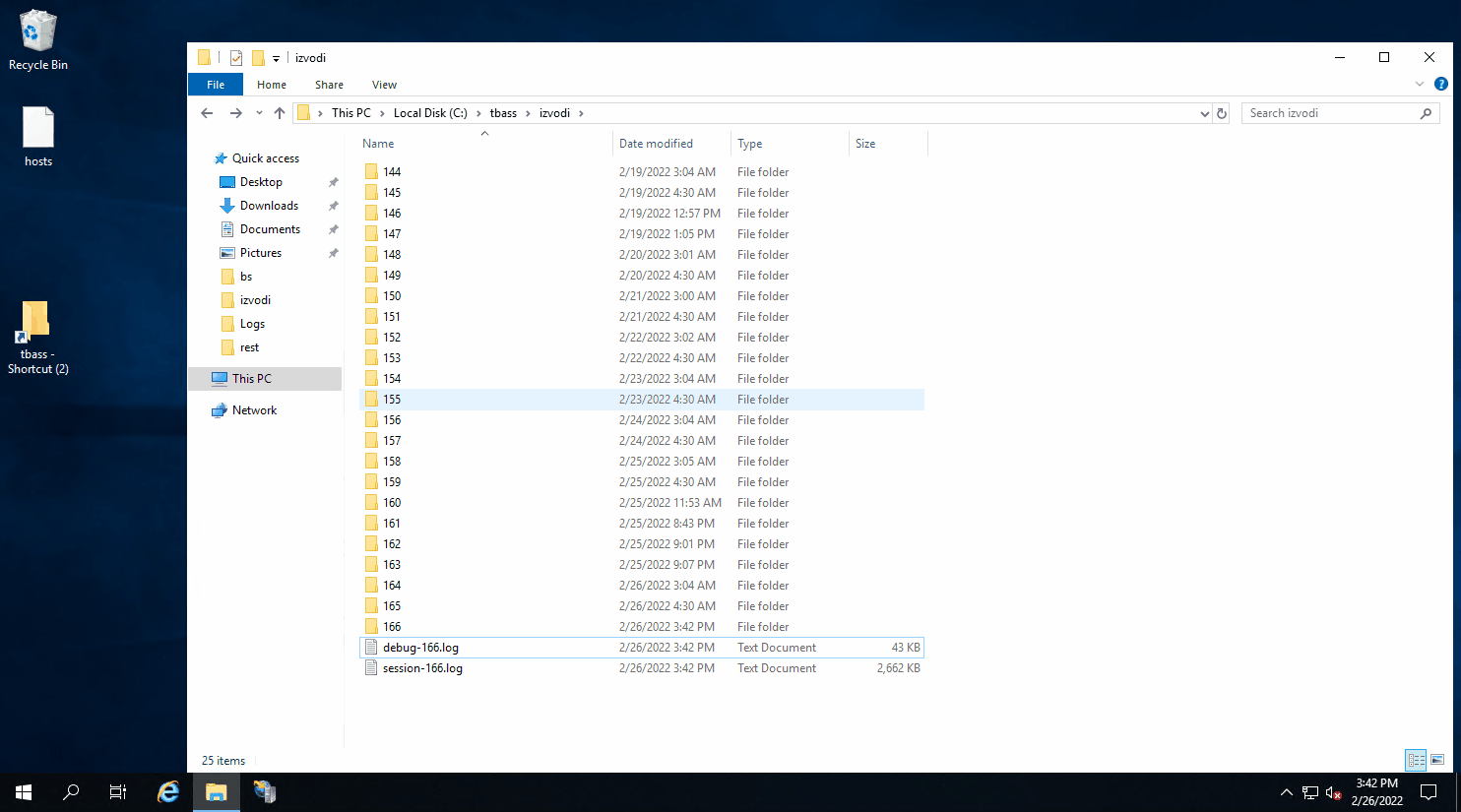

Until we wait for it to happen, here is the animated gif of how session constantly creates winscp.ini. I delete it constantly and it appears. I show you at the end session.log for this ongoing session.
You can see that this session log is being used as its size is growing, and that winscp.ini creation time changes with each ls.
All this winscp.ini mingling during the execution didn't produce winscp.ini access error though by any thread and this is the reason why is so hard to catch it.
OK, so it seems to be easy to reproduce the creation of the INI file. That's good.
