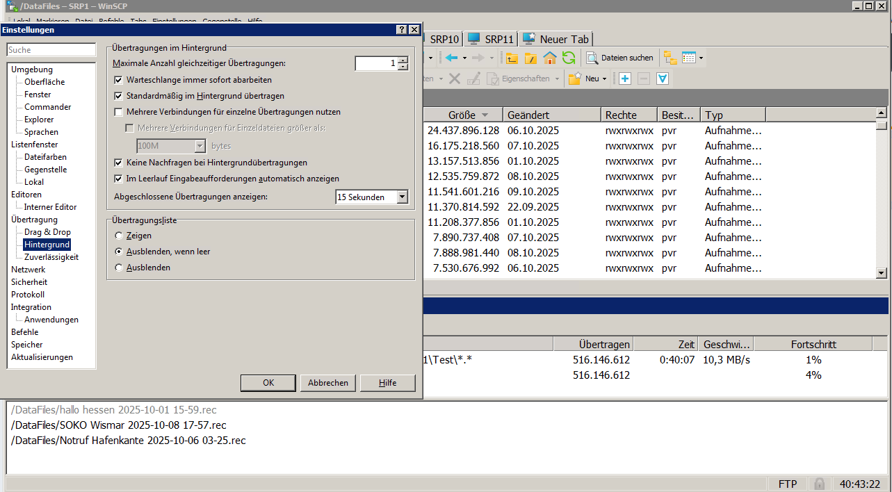

I know this is a necropost but I have a question regarding this. It's 2024 and I'm using the latest WinSCP. Two issues:
  1. the link you provide seems to link to old documentation. Many mentions of clicking "View" which does not exist.
  2. The feature that supposed to now exist does not seem to work for me. I have file list enabled, but it's only showing a single file transferring.
I wonder if for 2) the issue is I'm transferring an entire folder? Not a bunch of individual files? The transfer is listed as source: <path to folder>, destination: <destination folder\*.*, and then the next line is the current file transferring.
@mcdonamw: It's View in the Explorer interface, but Options in the default Commander interface. As the documentation says.
Regarding your problem: please post some screenshots.

Displaying a full list of queued files does not work when moving files
Displaying a full list of queued files does not work while moving files. (Using Commander mode)
It does work while copying files.
