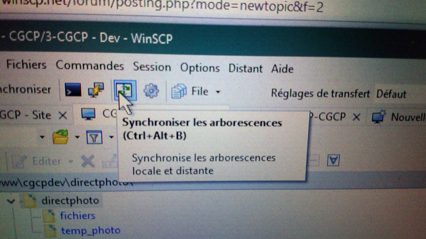

I recently updated WinSCP with version 5.14.5 RC (compilation 9281) and tree synchronization no longer works. That is to say that it must be given to each connection!
I didn’t have this problem with previous versions...
Thanks for the solution...

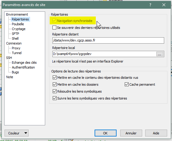

Prior to 5.14.5 in advanced site settings, synchronized navigation could be permanently enabled or disabled.
Now this option is grayed out and although activated the software does not have an account ... based on the reactivation of each connection!
Thank you for the solution or possible correction.
