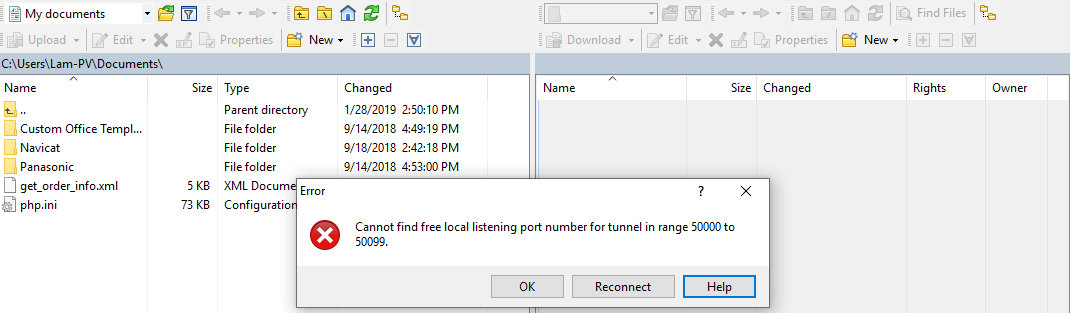

I'm having the same problem where the connect through SSH tunnel stopped working after an update
I've tried versions 5.15, 5.15.1 and 5.13.9
Windows 10 version 1809 build 17763.437
The error is
Cannot find free local listening port number for tunnel in range 50000 to 50099.
When I look in TCPView, there aren't actually any ports used in that range.
If I set the port manually to 49999 (which is free) I get
Network error: Connection "127.0.0.1" refused.
I also tried running it as an Administrator.
If I manually set the port to 51000 it works.

Cannot find free local listening port number for tunnel in range 50000-50099
Hey,
I started getting this problem after updating my Windows version to 1809.
The solutions listed here involve manually changing the port. How can I do that?
