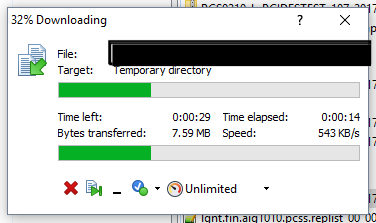

Suggestion: If possible when editing a remote file if that can be placed into a new/background process that won't interfere with you working in a remote session. This would be quite handy when working with large files.
EX. Edit text file that gets placed in a background process and keep working in WinSCP.
I may be being picky here, right now I just use PSFTP to download a file, but sometimes I need to edit large files that take a while and would like to keep working in WINSCP.
Thoughts?

Do I understand right that you want to put a download transfer to background?

Not sure if im describing this correctly. Mainly for the window that display that it is downloading the file to be placed as a background process so that you can keep working in the same site. So if were on the same page then yes?
Regards

The reason that I am requesting this is due to me working on large files. I have to wait for the file to download and the file sizes usually span between either a couple of Megs to Gigs. To be specific it takes a while for me to download a 4GB file and I have to do multiple edits to the same file.
So what happens when I open the file is that all WINSCP sessions are locked until that file is downloaded and some files take anywhere between 20-30 min to an hour sometimes. So this would be a nice to have to push the large files to a background process that will not interfere with one working in a session. I am not sure if moving the background process to it's own process thread would solve this?
