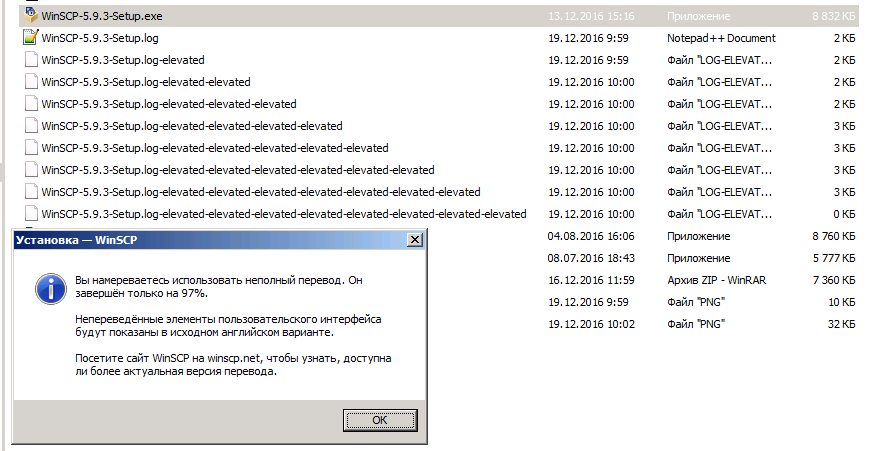

1. I start
cmd.exe /K D:\Distribs\WinSCP\WinSCP-5.9.3-Setup.exe /log=D:\Distribs\WinSCP\WinSCP-5.9.3-Setup.log
2. Log file is been created
3. A windows appears saying that Russian translation it only 97% and asks to press "OK". I press "OK" and the process restarted.
4. After that a new log file is been created like:
D:\Distribs\WinSCP\WinSCP-5.9.3-Setup.log-elevated
5. And every time I press "OK" a new log file is been created with adding -elevated to the filename end.

I looked throw the logs and found the line:
2016-12-21 15:32:20.051   Does not have write access to the last installation path [C:\Program Files (x86)\WinSCP]
I really think that when Installer sees that it does not have write access to the last installation path [C:\Program Files (x86)\WinSCP]
then it has to propose the path:
%APPDATA%
which is equal to:
{HOMEDRIVE}:\Users\{username}\AppData\Roaming
