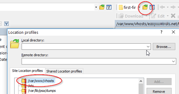

Yes, I got the bookmarks back when setting the specific session port, but when doubleclick onto a bookmark, nothing happens. I expect, that the specific folder will open. It is possible to sort the bookmarks, but the bookmarks are not working.

Please attach a screenshot of a selected bookmark.

See attached hardcopy. First I open the bookmark windows. Doubleclick on any bookmark will not change the directory as in older WinSCP versions.
Doubleclick works for newly created bookmarks, but not for stored bookmarks from older versions.

OK, so it's location profile, not a bookmark.
The profile has two entries, in the Local and the Remote subkeys of the Bookmarks key. And optionally also in the Options and the ShortCuts. You have to rename all of them the same way.

I've changed the specific registry entries and now I got back the expected function. There were only five entries to change with a different ssh port.
Thank you for your help.
