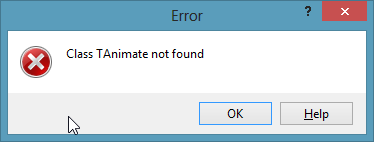

Dear all,
First issue I'm facing from time to time, is that WinSCP stops working and present the error message "Class TAnimate not found". After clicking away the error message the right panel of the command view is gone and WinSCP has to be restarted. Please see the attached PNG for a screenshort.

Re: A few Issues and Error: Class TAnimate not found
Are you able to reproduce this in a reasonable time?
I will try to reproduce it. So far, I do not see a pattern. If there's any debugging feature that you would like me to turn so that you can get more information about what was happening, please let me know. I can also use the VS debugger to look into the process, but I would need some guidance on where to look.

Karel Dytrych
I'm getting "Class TAnimate not found" almost every week. It never hapeeaned in previous versions. I have Win 10 and WinSCP 5.7.6.
How to turn on debugging mode? I would like to give you more info...
