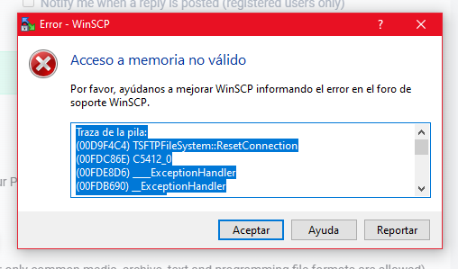

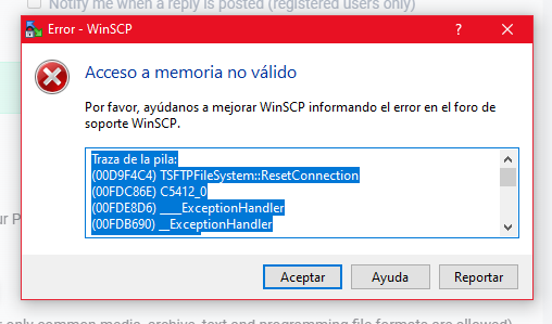

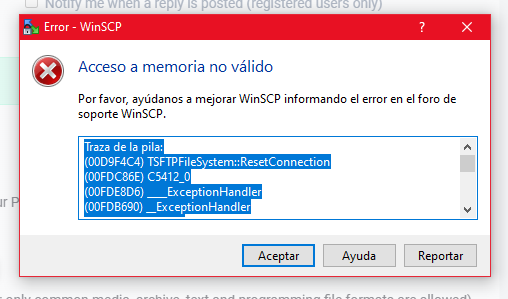

Acceso a memoria no válido - TSFTPFileSystem::ResetConnection
<Upon closing a session, error appeared:[/code]
[code]<Upon closing a session>
<Traza de la pila:
(00D9F4C4) TSFTPFileSystem::ResetConnection
(00FDC86E) C5412_0
(00FDE8D6) ____ExceptionHandler
(00FDB690) __ExceptionHandler
(00087B7F) ntdll.dll
(00D9E41B) TSFTPFileSystem::~TSFTPFileSystem
(00DD5B03) TTerminal::~TTerminal
(00D07A37) TSecondaryTerminal::~TSecondaryTerminal
(00D078D3) TBackgroundTerminal::~TBackgroundTerminal
(00D02C0E) TTerminalItem::~TTerminalItem
(00D013B9) TTerminalQueue::~TTerminalQueue
(000B3A7A) TTerminalManager::FreeTerminal
(000B38B2) TTerminalManager::FreeAll
(000B276F) TTerminalManager::~TTerminalManager
(000B222C) TTerminalManager::DestroyInstance
(0010B181) Execute
(000027FA) wWinMain
(00FDA881) __wstartup
(00066BBC) ntdll.dll.RtlGetAppContainerNamedObjectPath
(00066B89) ntdll.dll.RtlGetAppContainerNamedObjectPath[code]>
WinSCP 5.21.5
Traza de la pila:
(00FDC86E) C5412_0
(0010B181) Execute
(000027FA) wWinMain
