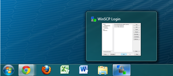

I have WinSCP 5.0.5 beta installed on Windows 7 (64) and am having the same problem. Version 4.3.6 also had the same problem. When I launch the program, it immediately appears in the taskbar, but the window will not come up. Clicking on it in the taskbar will not bring up the window although I can see the small preview window that Windows 7 shows for apps that are minimized in the taskbar... it is showing the WinSCP Login screen. I've attached a screen shot.
I've tried uninstalling and re-installing and rebooting. I've used an earlier version of WinSCP (4.?) for months on the same machine and never had this problem. It just started happening today.
Description: WinSCP Login preview window is displayed when mouse is placed on WinSCP icon in the taskbar.

I figured out the problem... the app was popping-up on a second monitor which I had turned off. :? Please disregard.
