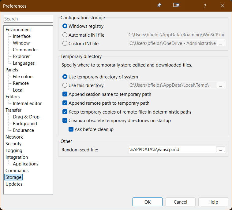

@Bill_Fields: It looks like you are editing the same file on two different servers. And you have enabled option "Keep temporary copies of remote files in deterministic paths", but not "Append session name to temporary path". With that combination, the two files are saved to the same local temporary path, overwriting one another, causing havoc.
Try enabling "Append session name to temporary path", it should resolve your problem. If not, please post new logs (and please try to reproduce the problem with as little opened sessions as possible).
Re: Logs attached
Sorry, you are indeed right.
Isn't it possible that you has multiple sessions to orbdb-orbdb-rep opened?

It was possible, but unlikely.
I captured a new set of logs, with just 3 sessions open. Please see attached.
